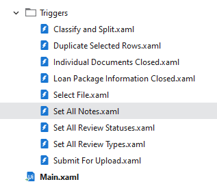

I’m guessing you have a Submit button, and then try to get the values. The new forms don’t work that way. The Submit button is closing the form before Get Form Values can execute. That’s not how you do things like this in the new forms.
This is how a proper form automation looks.
Main.xaml:
Then I have a trigger for a button clicked (Set All Notes.xaml)
Then it continues after that with the rest of the steps to perform when that button is clicked. Each event I want to respond to (for me they’re all button clicks, but you can also do events like "this field changed) has its own XAML with a trigger…
When you want to finally close the form and stop you do a Close Form then Stop Local Triggers. I have this at the end of my final step - the user is prompted if they want to submit another. If they select no, Close Form and then Stop Local Triggers:
