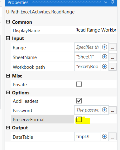

I am using a filter data table activity to keep rows that contain “TRUE” in a certain column.
For some reason, the output contains only the headers. I confirmed also with a message box “dt.rows.count” I got 0.
I also checked “PreserveFormat” in the read range:
Please advise.

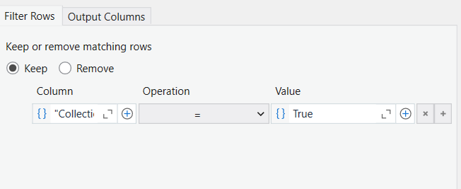

Try to use boolean value in the filter:

thanks @pikorpa ,still getting 0

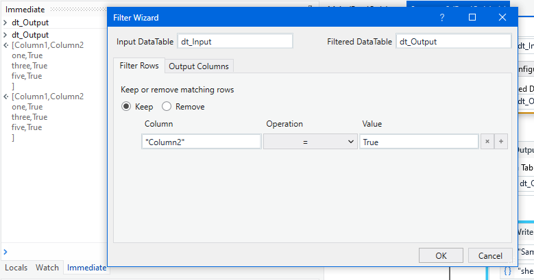

hmmm. It’s weird.
I tried recreate your Excel file. Take a look to this workflow. Filter activity works fine:
FilterDT.zip (9.7 KB)

Hi @hp321
Just remove the double quotes around the true and use the suggested name true while your giving you’ll get the output as you required
Or you can also select Filter rows - Remove - “Column2” != true
use this inbuilt true value

Yes, you must uncheck ‘PreverseFormat’ in properties and it will be works fine with true or false values

Thankfully, the issue had been resolved with your help. The filter worked after I unchecking the PreserveFormat. The Linq worked as well.
