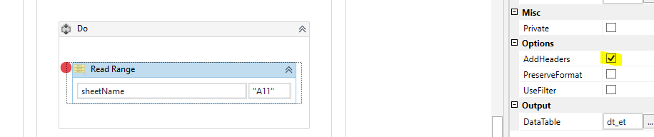

Can I see the headers of your excel and how you have configured your filter data table activity?
Additionally, also make sure in the read range, you have ticked the include headers…
@balkishan,
Are you sure you have checked the Add headers while reading the range?
or, there may be some spaces in the column names, so try copy and pasting the names from excel :slight_smile:

@balkishan You can see in the filter data table column type there is one space you remove that
Just try after removing the space and newline after the column name manually just to check if that is the reason @balkishan
