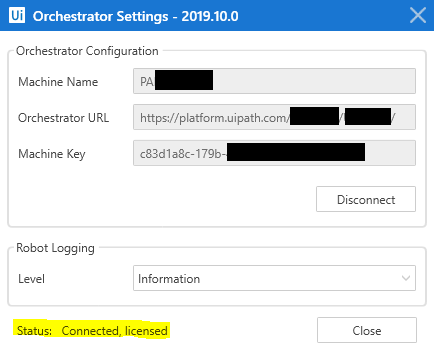

First I will check if my Robot is connected to proper Orchestrator Tenant. Please remember about using correct address for connection (more info HERE and please check out our DOCUMENTATION too).

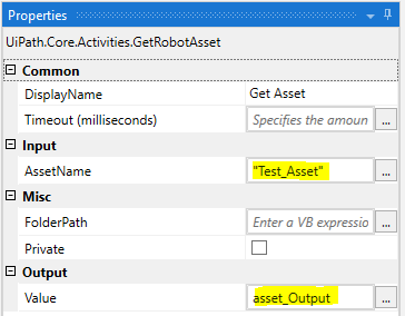

Now I can use right mouse button on my asset and copy it.
We need to put it into proper activity. In my case (as it’s text type of variable) it will be
Get Asset
. You can choose other depends of what you need to do in the project.
Now I will use my copied asset in activity’s properties and set it’s output to use in my process.
That’s how final project looks.
