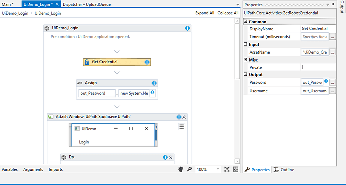

I have created Credentials asset in Orchestrator and trying to retrieving that in Studio using Get credentials activity. I am bit confused here and couldn’t bring it properly. Please help me through step by step process.

If your robot is connected to the Orchestrator, then the given asset name is read from the Orchestrator.
Make sure out_password is of type “SecureString”.
Yes, I got it. Thanks
