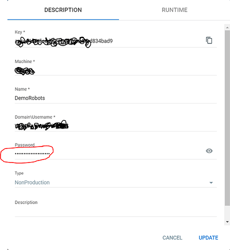

I was facing the same issue, but then I tried giving my machine password in the Robot which I was running. Earlier I left the password field blank as it is not mandatory and I was able to run my process using system Tray uipath robot. Now I can run my robot from orchestrator.
Attached is the screenshot where I entered the password.

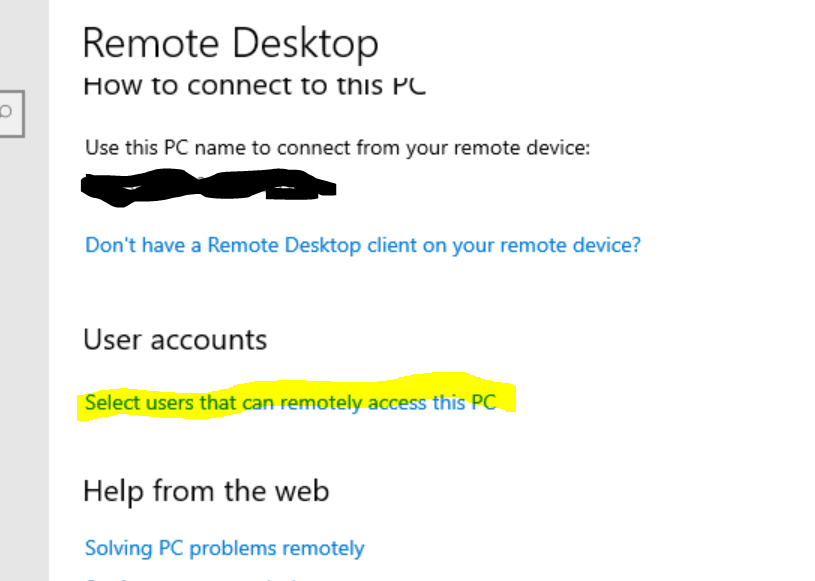

I know the post is obsolete but I have just resolved similar issue by adding manually the user to the users who can access the machine by RDP.
To achieve this, open the machine → go to Remote Desktop Setting → scroll down and open “Select users that can remotely access this PC”
Then click Add and put the email or user id to the text box. Click Check Names and select the correct user. After that Sign off from the machine and now bot Login to Console options should work.
