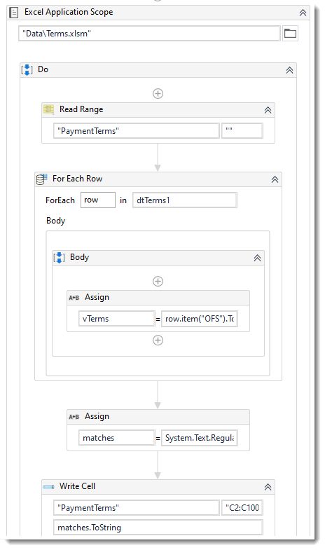

I would like to extract the data that is in parentheses from the “OFS” column and paste it into the “PT” column.
Expected Results:
I tested the Regex pattern and it works as expected:
However, this is the result I’m getting:
This is what I have so far:
RegexTest.zip (42.7 KB)
Any help would be greatly appreciated! :pray: :slight_smile:

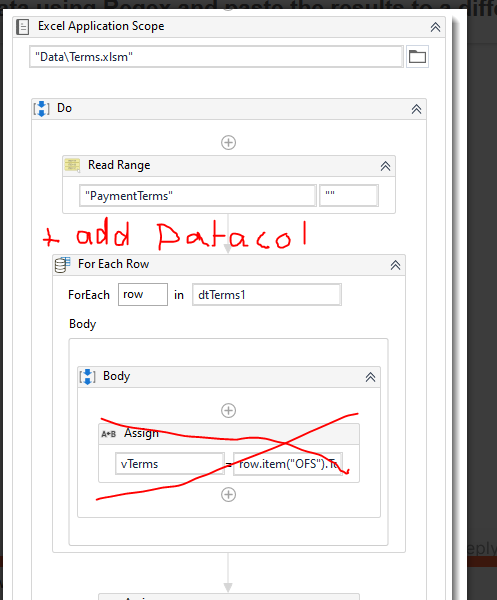

Have a look on following regex:
grafik
Change the flow like:
  • add data column PT if it is not already present
  • inside the for each row block do following
row("PT") = System.Text.RegularExpressions.Regex.Match(row("OFS").toString,"(?<=\().*(?=\))").toString
After the for each row write updated data back to Excel
Thank you! It works! :grinning_face_with_smiling_eyes:
