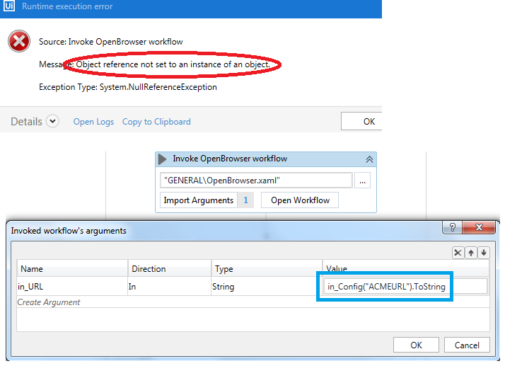

On the Reframework we have a file named ‘Config’ inside the folder ‘Data’. I’m trying to read one of the ‘Name’ property value from one of my .xaml files. As you can see I’m referencing or trying to read the Config file as the proper Documentation indicates but still getting that error.
I’m having the classic error about: “Object reference not set to an instance of an object” but I can’t figure out which object is not reaching. I think is not reading the ‘Config.xlxs’

You can use a MessageBox with: in_Config(“ACMEURL”).ToString before of Invoke Workflow for check if the variable has values. If message box return values pls tell us

1)-Kindly make sure that Config variable is passed as argument to this invoked workflow and that argument is used inside the workflow to access the value of that config
As shown on the PIC the variable is passing as argument and yes it is declare as an argument inside its workflow as: in_URL/In/String (name, direction, type)

Args are passing in the proper way I believe as the PIC shows.
Probably the arg is not been properly used when reaching the workflow invoking it

How can I use to check or catch the config dictionary, that’s where I think the issue is. I’m not sure how to get the Dictionary info properly, I thought: “in_Config(“URLTEST”).ToString” it was accesing the Dictionary as I know from samples
