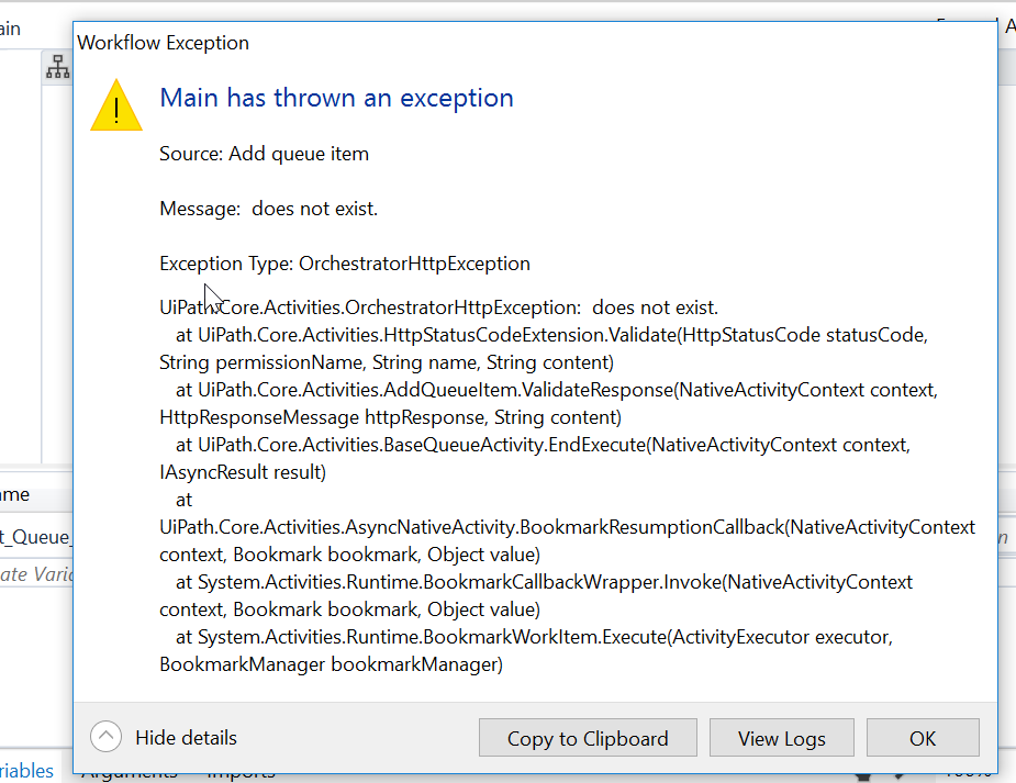

Folks,
I am trying to add a queue to orchestrator and keep getting following error. Can some one please help?
Folks,
Hello!
Hereâs a guide to add queues on Orchestrator. Try to follow it and see if the error persists.
Also, thereâre a free training about Orchestrator. Have you done yet?
Register here: UiPath Academy
This was helpful
Should have searched more on knowledge base. Thanks a ton
Hi there @chinnapureddy03,
If your QueueList object is null at the point of trying to access it with âToListâ, an Exception will be thrown.
Can you confirm whether the object is populated beforehand?

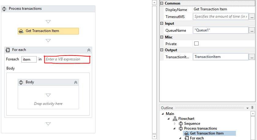

please suggest which value i have to place in red box below, im getting confuse. already i added values in queue, now i want disply all values in message box. How?
What should i do next step, please any one help me out
When you use the activity âGet Transaction Itemâ, you are retrieving a single queue item.
As such, thereâs no reason to include a âFor Eachâ.
If you are looking to retrieve the information stored in a single item, then you can use:
TransactionItem.SpecificContent(âKeyâ).ToString
Each queue item will have a Dictionary of type:
String [Key] Object [Value]
So the above will lookup the key âKeyâ and return its associated value.
With that said, if you are looking to retrieve all available queue items, you should use the activity âGet Queue Itemsâ, which returns an IEnumerable of Queue Items, which you can then use a âFor Eachâ on.

@Mr_JDavey In my studio i donât have "Queue item " activity, so using get Transaction activity , i want to get all values, so please make one workflow for my understanding purpose
When you use the âGet Transaction Itemâ activity, you are returning an object of type âQueue Itemâ.
In your case, you have named it âTransactionItemâ.
If you wish to retrieve the values stored in its dictionary, please refer to my above post.
However, if you would like to loop through all items, then use the activity âGet Queue Itemsâ, which returns an IEnumerable of Queue Items.
I am certainly happy to assist further, but you will need to clarify exactly what your expected outcome is.
Would you like to loop through:
Thanks once again,
Josh
