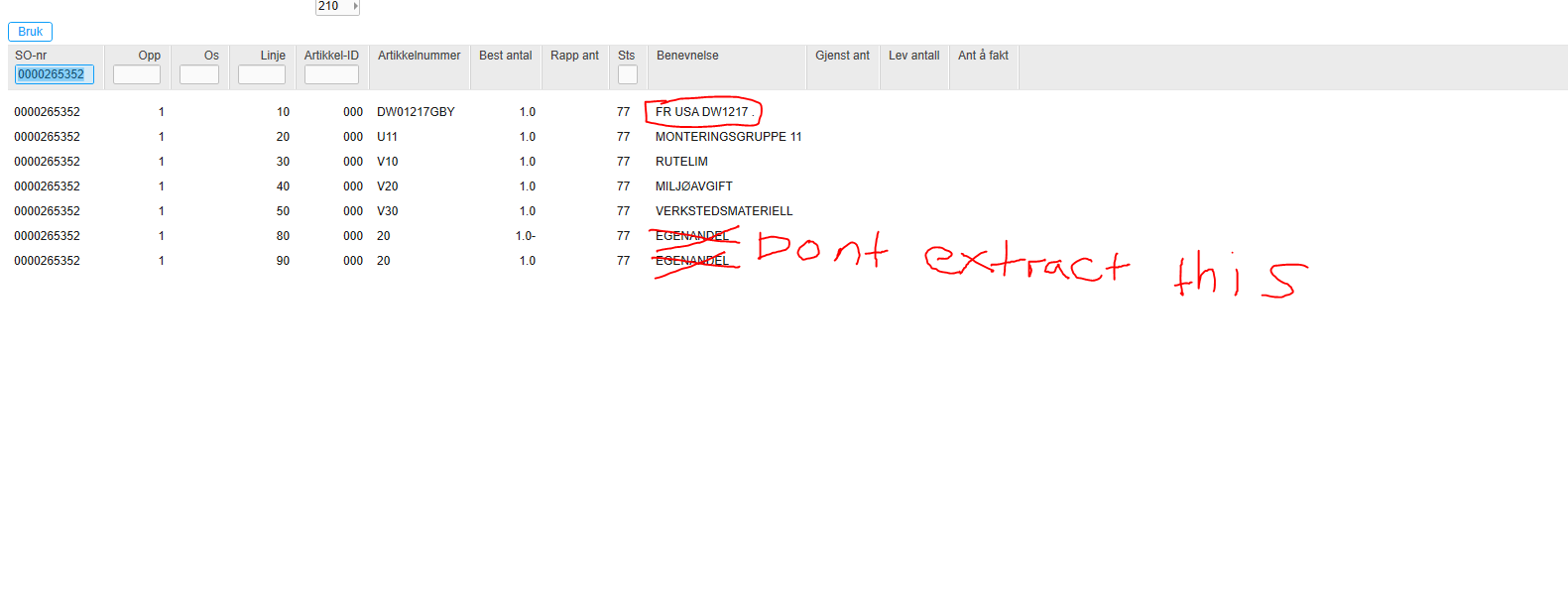

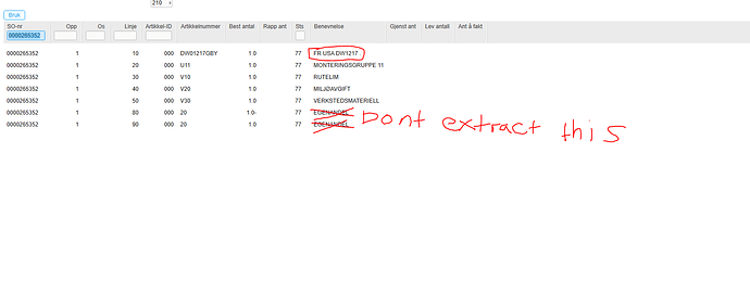

Hello! I am trying to perform some dynamic retrieving.
I have a list thats dynamic. Thought of maybe use a case statement that checks whenever the line contains certain words etc… but its not very precise
So the lines can change based on what job i am inside also position of the line. But want to retreive specific lines and add them to a standar variable if the line exist

yh the list its defined by a index number that i can create a var upon to get down on the list. but dont know how to retrieve the actual info on specific elements
