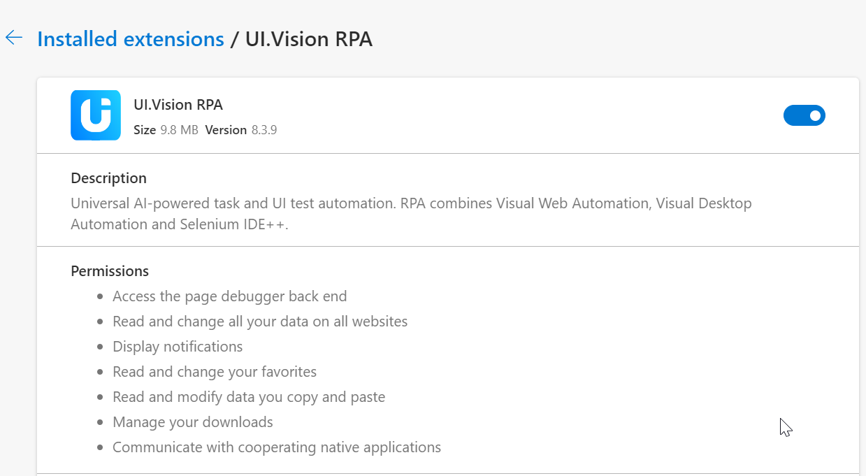

Hello guys
My script is generating this error related to edge extension however I already installed & enabled it
If any one can support please
Seems like it’s not the correct extension. Please install it from Studio instead:
This is not UiPath extension please check in the studio in the tool tab you can get the extension
you have to do this in studio go to home-tools-UiPath extension and click install once installation is done open the edge browser turn on the extension.
That’s not the UiPath Edge extension. Go to Studio, Home, Tools, UiPath Extensions, and install the one that says Edge.
