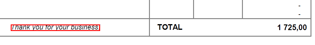

Before I run the program I validated the GetText activity and click
Highlight Button
it highlighted the Amount as indication that I selected the right element. But after I replace the Name Value on the Edit Selector to (*), validated (it turned into green) but when I tick the Highlight again it highlighted the Thank you for your business!.
This is the before image.
and After
that is why I am getting wrong value. Please Help.
