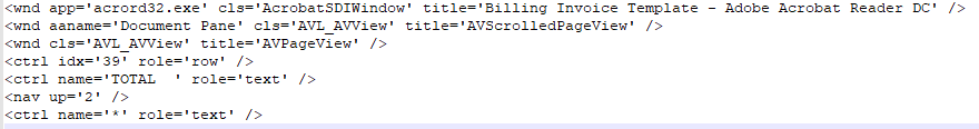

Sure here it is
@tarun2307
Fine!!! get text activity will take more time. If its same format we can process in this way like,
Read pdf text and store it in a var(String) . then just we use regex expressions on that string to get your preferred text.
Just share the string from that what you want to extract from that sequence or string.
@tarun2307
Kindly change the Selector to dynamic and use the unique property.
For eg: check Title has “Billing Invoice Template” is the same for all Template.
and aaname
If you share xaml and sample file we can help or share the selector for two pdf.
