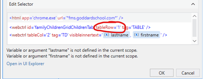

here is the selector.
I hold variable which enters last name and first name to search and Name gets listed like below in the table. suppose if i need to click on the last one, how do i do it, here is the selector information.
I have attempted to set one, based on your suggestion, maybe i did not get it right could you check on it

@Ayesha_Ijaz,
Remove the tableRow='2' attribute and try.
Hi Ashok, for some reason, still there is an error
variable or argument lastname is not defined in the current scope but i have already declared it.
The image shows the "Edit Selector" window for a web control in an automation tool, indicating that the variables "lastname" and "firstname" are not defined in the current scope. (Captioned by AI)
let me know your availability for a quick connect ?
@Ayesha_Ijaz,
Remove from here as well and try
The problem was with adding the variables in the selector. You can add the variables by cutting down the selector string with like this “+varname+”.
