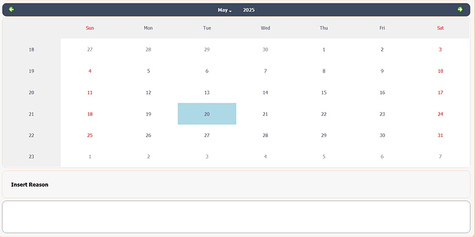

Hi Everyone,
I have some input data in an xlsx file (containing columns for Dates and Reasons). I want to select a date and then fill in the reason, and I need to run a loop for each row (I have hundreds of rows to fill). Could you suggest some best practices or approaches I should use to create this bot? Alternatively, can I automate this process using the REFramework?
Thanks

@prashant1603765 Hi
Can you help me with which activities should I pick to automate this ?
I have list of dates in excel sheet & select those accordingly on the calender
Thanks
Namam
Hi @Naman_Arora
try below steps:
Use Excel Application Scope to open the file and Read Range to read the data into a DataTable. Then, use For Each Row to loop through each row. Inside the loop, use Click to open/select the date on the calendar, Type Into to enter the reason, and Click again to save or confirm if needed. Repeat for all rows.
