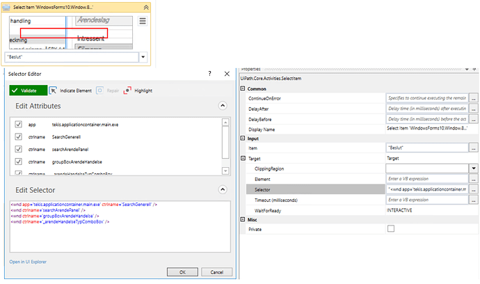

However, the SelectItem Acitivy was able to find the values in the dropdown:
selectItem
However, for some reason it’s not selecting this item when running the process.
Key down etc can be sent (I have done it like this now), however, as the values in this dropdown can be changed I wanted to select a specific item per name.

Can you show the selector from select item that currently identified Beslut? Thanks
Yes, here it is:
Can there be a reason that UiPath cant’ identify this element at all? I mean, is it maybe not possible to get this done at all?
