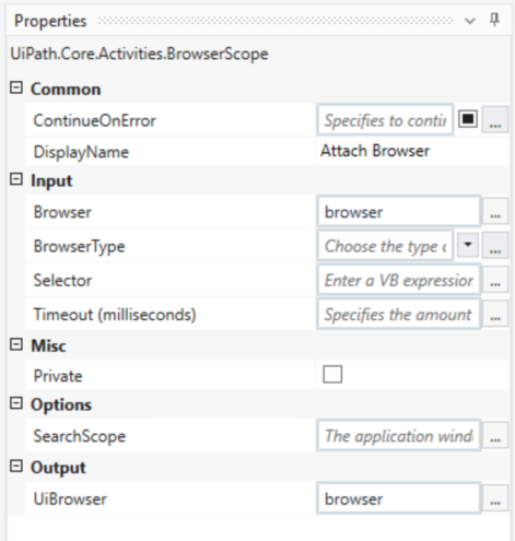

When you open the browsers, set output variables.
Use the same variables later on when Attaching to the different browsers. That way you can be sure which browser the automation is using.

Oh, I see. Did you try anyway? You could also see if Attach Window would help (you should be able to pass a Browser variable to it by using browser.Element).
