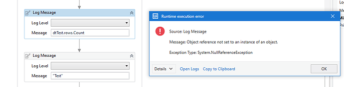

Testing on 2021.10.3, when I create a forced failure, the process runs and highlights the activity/brings up a prompt displaying:
I have also used an Invoke Workflow and tested that is highlights the same activity from within the Workflow.
Are you making use of a Library? - If so, the Process will not highlight the underlying activity, only the overarching Library activity.

This is what I get. Just a message where you cannot make any sence of:
This happens in the middle of the flow, not at the start
