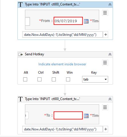

use type into activity and check below screen shot.

Check EmptyField option into properties of Type Into activity and then try once. By enabling this option it will clear existing data and will enter new data.

I have used empty field it’s clear existing value.But how to move from date to To date i have used “Send hot key” activity for move one tab to another, but it won’t work

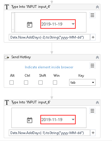

How to set current date current date i have used this method
“Date.Now.AddDays(-1).toString(“yyyy-MM-dd”)”
In Type Into Activity, click on that plus + and then select tab to go to next field.
Yes you are entering correct only.
Hi @lakshman
Thanks it’s working fine.
Could you please let me know how to current date. I have used below things for date declare.
From Date: Date.Now.AddDays(-2).toString(“yyyy-MM-dd”)
To Date: Date.Now.AddDays(-1).toString(“yyyy-MM-dd”)
When i used above things it will took from date is “18-11-2019” and To date is “19-11-2019”
But i want to use current date for to date
How to declare
