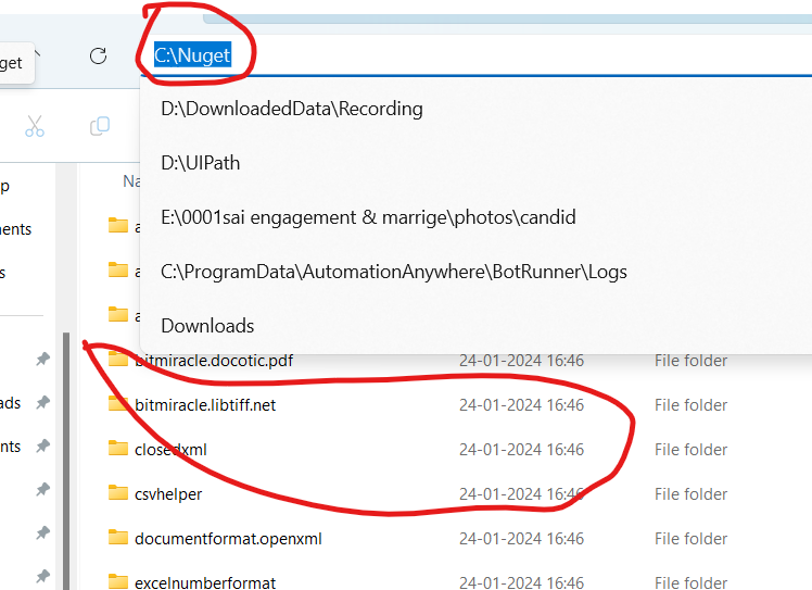

@Kunal_Jain
Please check the path properly…as I just made the setting and it is workign as expected
