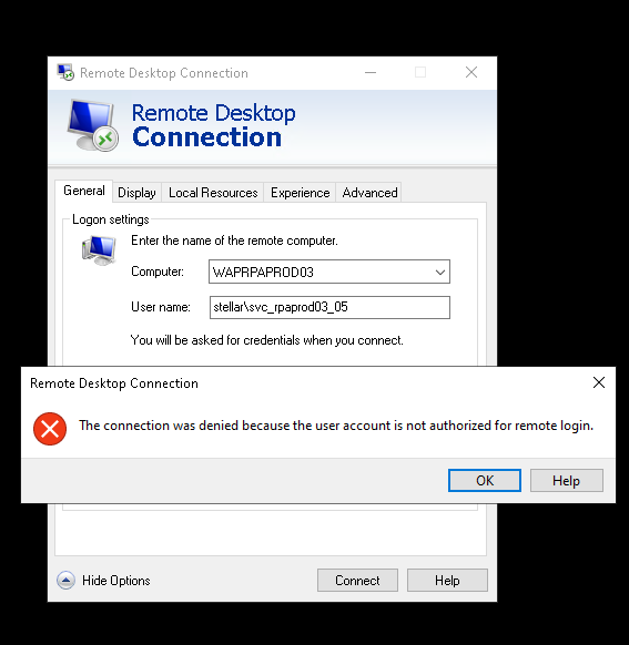

It’s weird that this is random, but can you make sure the user the robot is running with is present in the Remote Desktop Users in here:
