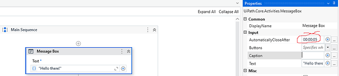

There was a message box activity used in the workflow, which shows a popup message. It will not go away until and unless configured accordingly or closed manually.
Where do we need to configure that?
@Ashish32229,
I would advise to not to use Message box in unattended bot’s. To log something use Log message.
If you still want Message Box configure it’s property AutomaticallyCloseAfter to your desired timeframe.
