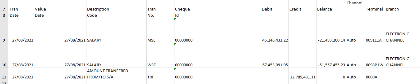

@rahulsharma Output is not correct.
test.xlsx (10.5 KB)
Output from Bot as below.
But correct data as below.
Please guide me for solve it.
Then in the inner loop, for splitting via spaces, Remove the 2 and make it 1
also before adding to datatable using Add Data Row, have a IF condition
row.tostring.contatains(“/”)
This will add only rows with date as you want
