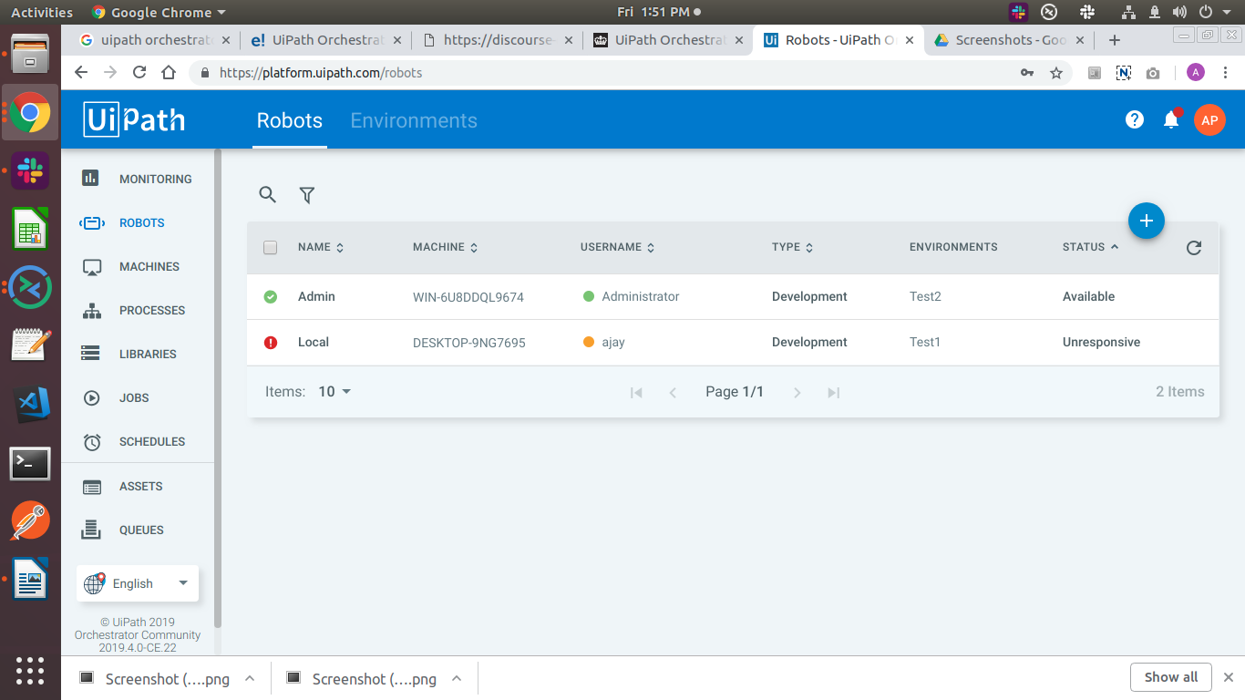

How to create Robots in Orchestrator?
To create Robots, go to the Robots Tab, and click on the “ + ” option. When you click on the Plus option, you will see the following three options:
An option to create a Standalone Robot. This robot will work only on a single standard machine.
An option to create Floating Robot. This robot will work on any machine
An option to close
You can choose to create any type of robots, as per your need. Here I will be creating a Standalone Robot. So, once you choose the option to create a Standalone robot, you have to mention the Machine Name, Name, Domain Name, Password, Choose Type and Description. Then click on Create.
NOTE: To know the Domain Name, you can go to the Command Prompt and type the command “ whoami “.

If you wish to check whether your Robot is available or not, you can go to the UiPath and see the status to be Available. Refer below.

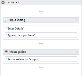

To create a Process in Orchestrator, you first have to create a project in the UiPath Studio and then Publish it.
So, to do that let us consider a Project wherein, we are asking the user for Details and then we will display the details in a Message Box. Refer below for the sequence.
NOTE: While you are saving your project, remember to save it with starting 0’s as Orchestrator does not list down all the projects which are Published. So, to make sure your project is listed in the Orchestrator give your project name starting with 0s’ and then end with a name. Here, I have named by Project “TimeSchedule”.

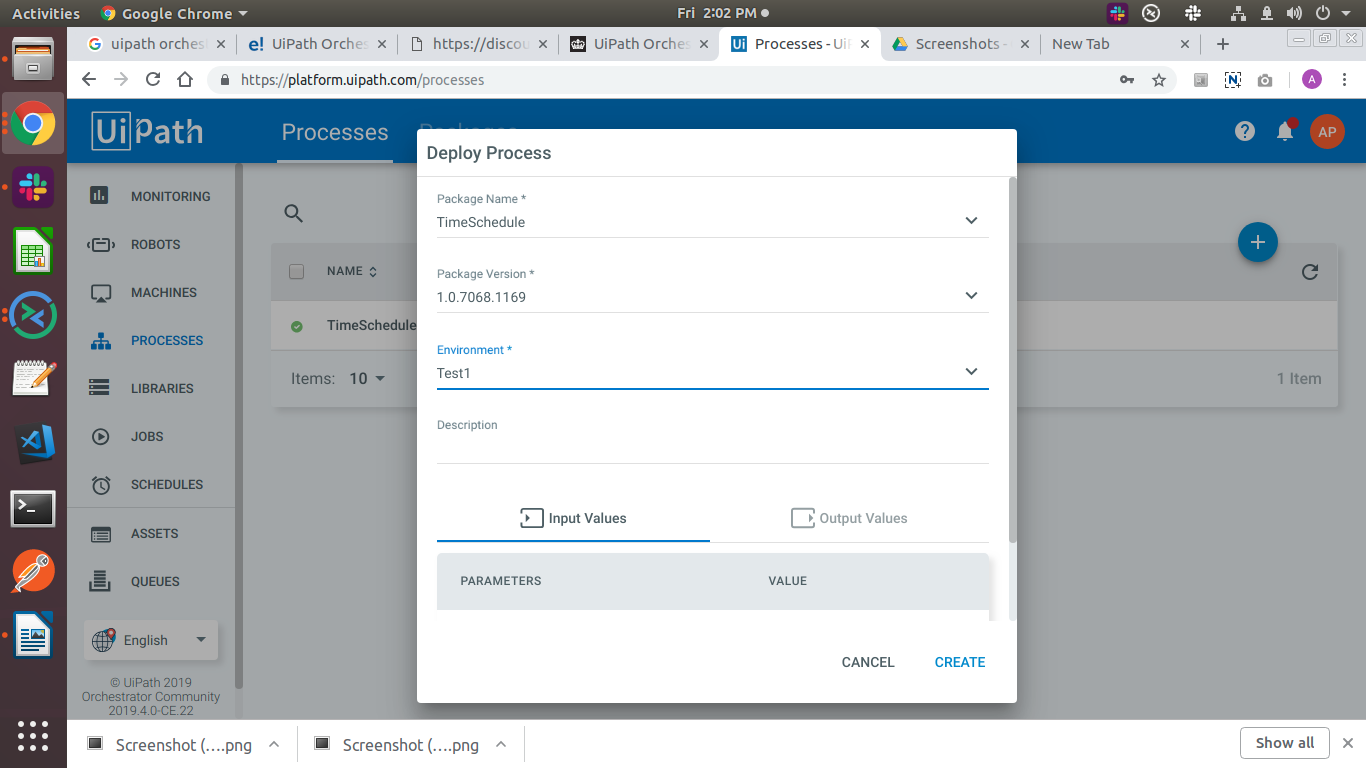

Once your project is published, the next step is to create a Process.
To create a Process, go to the Process Tab , and click on the “+” option. When you click on the Plus option, you will see the following dialog box to create a Process. Mention the following :
Package Name(Your published project name)
Package Version
Environment(The environment which you created above)
Description
Once you mention all these details, click on Create to create a process. Refer below.

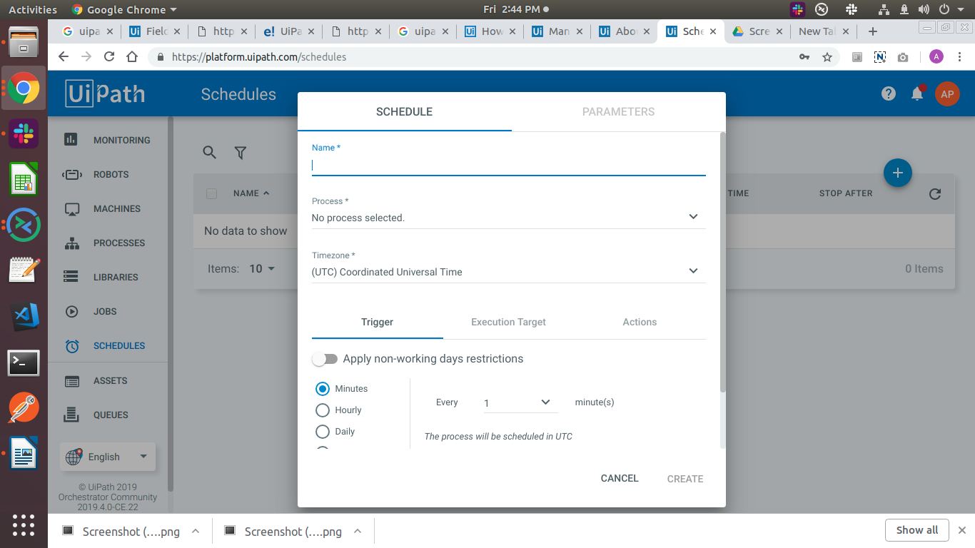

T he next step is to create a Schedule .
Schedule enable you to execute jobs in a preplanned manner, at regular intervels on Robots. Input values for processes which support input and output can be managed at this level as well. You can assign Robot to perform different schedules according to the foolwing options.
- All Robots- Schedules are executed by all the Robots in aspecific environment.
2.Specific Robots- Schedules are executed by the Robots selected by the user.
- Allocate Dynamically- Define how many times a process is to be executed according to the given schedule. This option enables you to utilize your resources to their greates extenst. As soon as a Robot becomes Available, it executes
the indicated process according to the provided schedule. Keep in mind that the execution time of the schedules can be adjusted according to a specific time zone.
The Schedule page enable you to create new schedule. It also displays all previously created schedules, which can be further adited, enable, or disabled
You can view the jobs started by a specific schedule on the Jobs windows, byt seleding MORE ACTION>VIEW JOBS . A schedule job can also be stopped after a custom amount of time with the STOP or KILL option on the ACTION tab.
