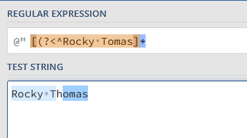

I have used finding matching pattern matches with pattern as - “[(?<^”+str2+“]+”
with input as str1

Because your pattern : [(?<^”+str2+“] matches characters which exists inside square brackets, and both string contains “h”
And also I don’t think this pattern works for your requirement even if the first example. Can you share your actual expression using screenshot etc?

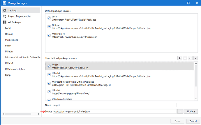

in this case, perhaps you should use diff library instead of regex.
Can you try the following sample?
Sample20230427-1Lv2.zip (2.8 KB)
As this sample uses Diffplex library, please add nuget.org as feed in settings of MangePackage.
https://api.nuget.org/v3/index.json
