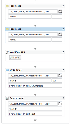

Hi @Mr.H
Please try this,
Use a write range activity,

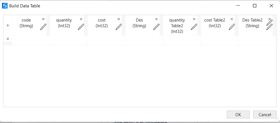

dt1 - datatable from sheet1
dt2 - datatable from sheet2
dt3 - from build datatable
(From dtRow1 In dt1.AsEnumerable
From dtRow2 In dt2.AsEnumerable.where(Function(row) row("code").ToString.Equals(dtRow1("code").ToString) And
((CInt(row("cost").ToString) >= 0 And CInt(dtRow1("cost").ToString) >= 0) Or
(CInt(row("cost").ToString) < 0 And CInt(dtRow1("cost").ToString) < 0)))
Let code1 = dtRow1("code").ToString
Let qty1 = dtRow1("quantity").ToString Let cost1 = dtRow1("cost").ToString
Let des1 = dtRow1("Des").ToString Let qty2 = dtRow2("quantity").ToString
Let cost2 = dtRow2("cost").ToString Let des2 = dtRow2("Des").ToString
Select dt3.Rows.Add({code1,qty1,cost1,des1,qty2,cost2,des2})).CopyToDataTable
and then use an append range activity,
(From dtRow1 In dt1.Select
Group By k = dtRow1("code").ToString Into grp = Group
Where Not dt2.AsEnumerable.Any(Function(x) x("code").ToString.Equals(grp(0)("code").ToString)) And (CInt(grp(0)("cost").ToString) >0 Or CInt(grp(0)("cost").ToString) < 0)
Select  grp(0)).CopyToDataTable
Output
test.xaml (10.7 KB)
Thanks

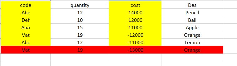

Hi Bro.
Sorry, i have added one row into the Sheet1 ( red highlight )… but this row not added into the result Sheet.
Could you pls check!
Book1.xlsx (11.3 KB)
Hi @Mr.H
Is the code vat present in sheet2?
If it is not present it will create only one row right?
Thanks
Hi Bro.
It not present in Sheet2… then it will take all of that row from sheet1 and add into the result sheet.
Any row in Sheet1 not present in sheet2, it will bring row in sheet1 into the result sheet.
If the sheet1 has 2 row “vat” , it also create 2 time… not only one.
Thanks you!
@Mr.H yes i understood, will tweak the code and come again
Thanks
@Mr.H Have changed it please check now and let know if any changes required,
  1. Dont need to change anything in write range
  2. Add remove duplicates activity after write range and pass dt1.
  3. In append range use this code,
(From dtRow In dt1.AsEnumerable
Where Not dt2.AsEnumerable.Any(Function(x) x("code").ToString.Equals(dtRow("code").ToString)) And (CInt(dtRow("cost").ToString) >0 Or CInt(dtRow("cost").ToString) < 0)
Select  dtRow).CopyToDataTable
Thanks
