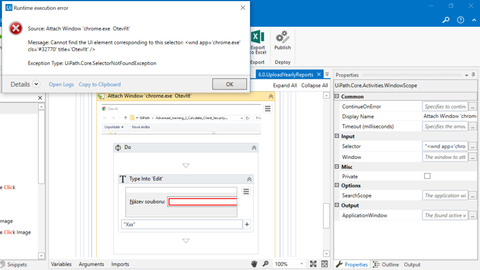

I would like to ask you for help. I have been trying to set a robot for Assignment 2 and I cannot deal with an easy task. I would like to use “Click Activity” in order to be able select the yearly report and upload it. But when I click on “Select Report File”, it does not react at all.
My Selector is set up as follows (btw SimulateClick is active):
But when I run the robot, I receive an error of the following activity which attaches a window which pops up when it is clicked on “Select Report File”.
Any idea what is wrong with my robot?
Thank you very much in advance!

Do you mean to use UI Explorer? If so, I have checked it and it is validated. See the picture attached.
No buddy try to use a attach window activity and place that click activity within that activity buddy
Cheers @haraslub
It works! Thank you a lot, I appreciate it!
Btw I do not understand it. I had already used a attached window activity in steps before because I needed to use “Type Into” and “Select” activity on the same page.
