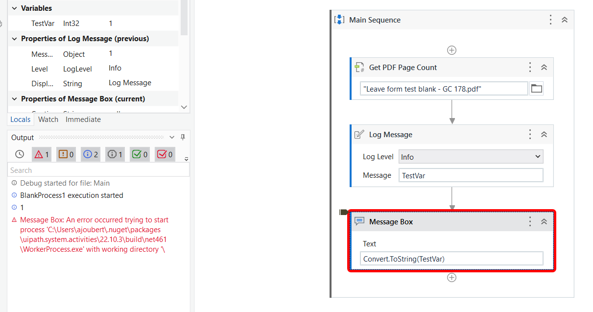

Once we found it our team was able to whitelist and this resolved our extension issue but there was a second EXE file that needed to be whitelisted as well for the automation popups to work properly… error is shown below:
We found this exe easily enough by following the error path to C:\Users\(userrname)\.nuget\packages\uipath.system.activities.22.10.3\build\net461\WorkerProcess.exe
After both of these where whitelisted everything seems to be working properly. I hope this post helps anyone in a similar position and that UiPath can document this more thoroughly for folks in heavily managed Group Policy environments such as government etc.
