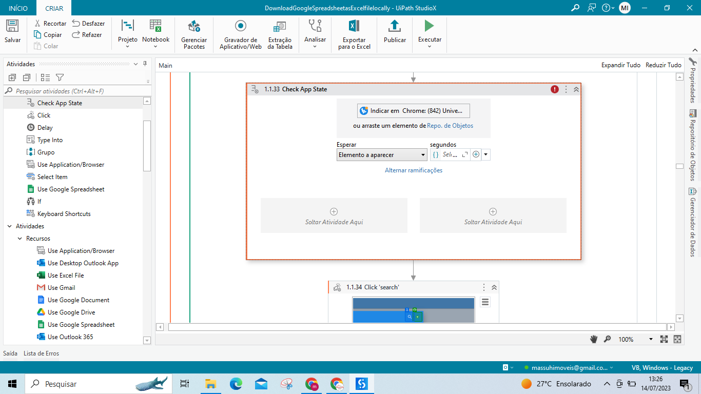

Hello, so the activity that I place in the left side is whats going to happen if the element appears? This is my main doubt
Hello, so the activity that I place in the left side is whats going to happen if the element appears, and the right side if it doesnt? This is my main doubt

Hi, I dont have the sequency block tho.
@Carvalho_Vini
Are you using element exists or check app state…
If check app state then you will have a element appear on roght and element did not appear on left
If element exists then you can use the output of it in the if activity
here
@Carvalho_Vini
You do have a left and right sequence right…its just hidden…it is a setting in your studio to hide or show sequences…if you switch it it would show the sequence also…else it would just hide but the sequence is still oresent

Hello again! So, it says that wasn’t possible to find the UI, but since it didn’t appear, isn’t supposed to do the activities on the rignt then? Thak you for your support!
@Carvalho_Vini
Yes…ideally if found it would move to left and if not found will move to right
It worked, thank you!!
