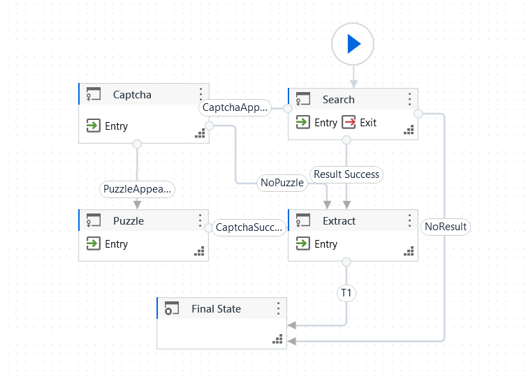

Here’s a screenshot of the workflow :
Here is the “Check App State” activity in the “Trigger” section of the Capcha Transition :

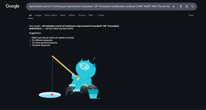

Here is the result of the page :
As you can see the there’s no result, which should lead to the NoResult Transition and direct the process the Final State. BUT, the Captcha Transition State was triggered as true, as you can see in the logs :

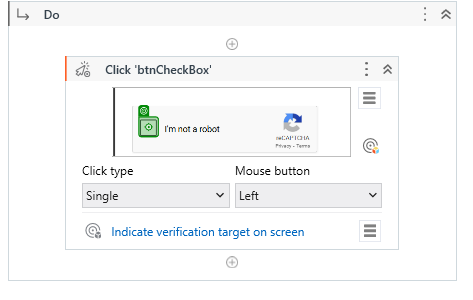

Then the process tries to tick the ReCaptcha box via I “Click” activity, which of course doesnt exists because it hasn’t really appeared.
