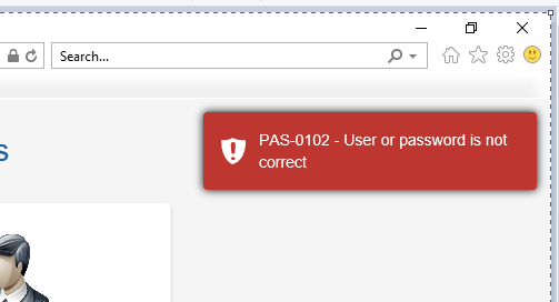

I want to capture this wrong credential pop-up, But this is visible on the screen for 1-2 sec, when we capture it automatically disappears from the screen, can you please suggest me how can I capture it. It’s not giving time to me capture it, It suddenly disappears.
Note - If you keep the cursor on it, it will visible on the screen, once you move the cursor from this popup, suddenly it’s removed.

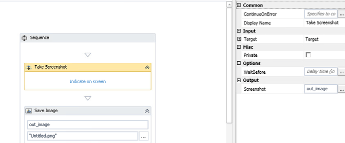

yes like this
–once after logging in useTAKE SCREENSHOT activity and SAVE IMAGE activity like this
–then use START PROCESS activity and pass that file path of image mentioned in SAVE IMAGE activity so that it will open that image in FOREGROUND
–then use IMAGE EXISTS ACTIVITY so that we can confirm that image occured or not
Cheers @balkishan

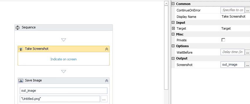

Hi understood, but lil confused also.
Like in Take Screen Shot activity, do we need to capture the particular screen, where it’s showing the wrong username/password. Or Automatically it will take the screenshot of the page.
  1. In the start process in the first field I can the Image path, so in second field what I have to give.
I want the True/False boolean value of the start process. ? Will it give the boolean value.
the place before where we will getting that image so that whether that mage occurs or not let the screenshot be taken
any how we are going to validate that with IMAGE EXISTS after START PROCESS activity
Till this is enough buddy
we dont need to mention any arguments in that field
No start process wont but we can use IMAGE EXISTS activity
that is start process will open the image to the foreground and this image exists activity will check for that image and if its there then it will give us a boolean output
hope this would help you
Cheers @balkishan

Actually the when we click on the Login button, the image is visible for 3-4 second. I have used the element Exist. But it gives me the False result. If the Invalid username & Password screen visible it should give me True result. But it gives me False result. Please suggest .
Below is the screenshot.
when robo insert the wrong credentials, this popup message came for 3-4 second. I already used the Element Exist Activity for this. But it gives me the False result. Even this popup came after putting the wrong credentials.
@Palaniyappan @Lahiru.Fernando

This popup shown on the same Login page bro in the top right corner.
It’s visible only for 2-3 second after that dissapear.
