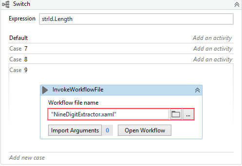

@Niranjan_k,
So what I understood it that you will have 7,8,9 digit ID’s and the logic to extract information is different for each.
If this is correct understanding,
Build different workflow with different extracts and use Invoke Workflow file activity to call/run that logic form the case.
Like this
Thanks,
Ashok :slight_smile:
@ashokkarale Thanks for great logic, Here i have doubt they will group of IDs which includes all the 7,8,9 digit IDs.
End how can i merge all the details into one excel. if we have 3 workflows sorry not sure how to merge the data. End i need to create common output, with all the 7,8,9 digit IDs.
  1. Initialize one DataTable variable dtFinal before Switch case.
  2. Define Out argument of Datatable in each data extraction workflow.
  3. After every invoke workflow in switch case, use Merge Datatable activity to meagre the datatable extracted form that particular case into dtFinal
