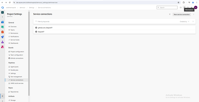

first try to go to the Market place–>Browser market place–>search for UiPath–>install UiPath integration–>go back and check the in azure.Hope this might help you @Ayush_Raj.
