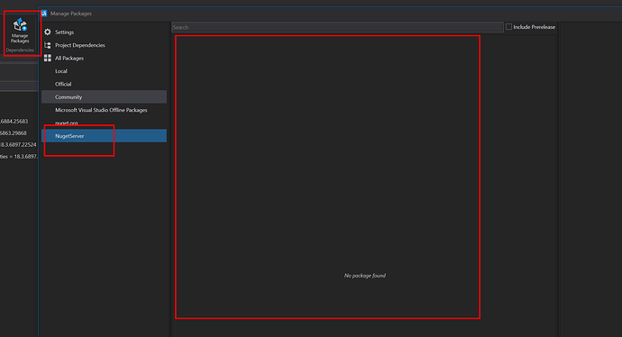

Same here. I have created a test nuget package having a simple class to be used within UIPath scope. When doing the steps locally (creating dll in release from Visual Studio Solution / creating nuget package / adding package to UIPath folder / adding package in “manage package” window in UIPath), it works like a charm.
But, when using Azure Devops (formerly VSTS), linking the azure artifact package feed to my local and trying to link it, the package simple does not show in my UIPath window (image below).
As you can see, the nuget server is detected by uipath, but not the package itself. Have you guys added support for this?

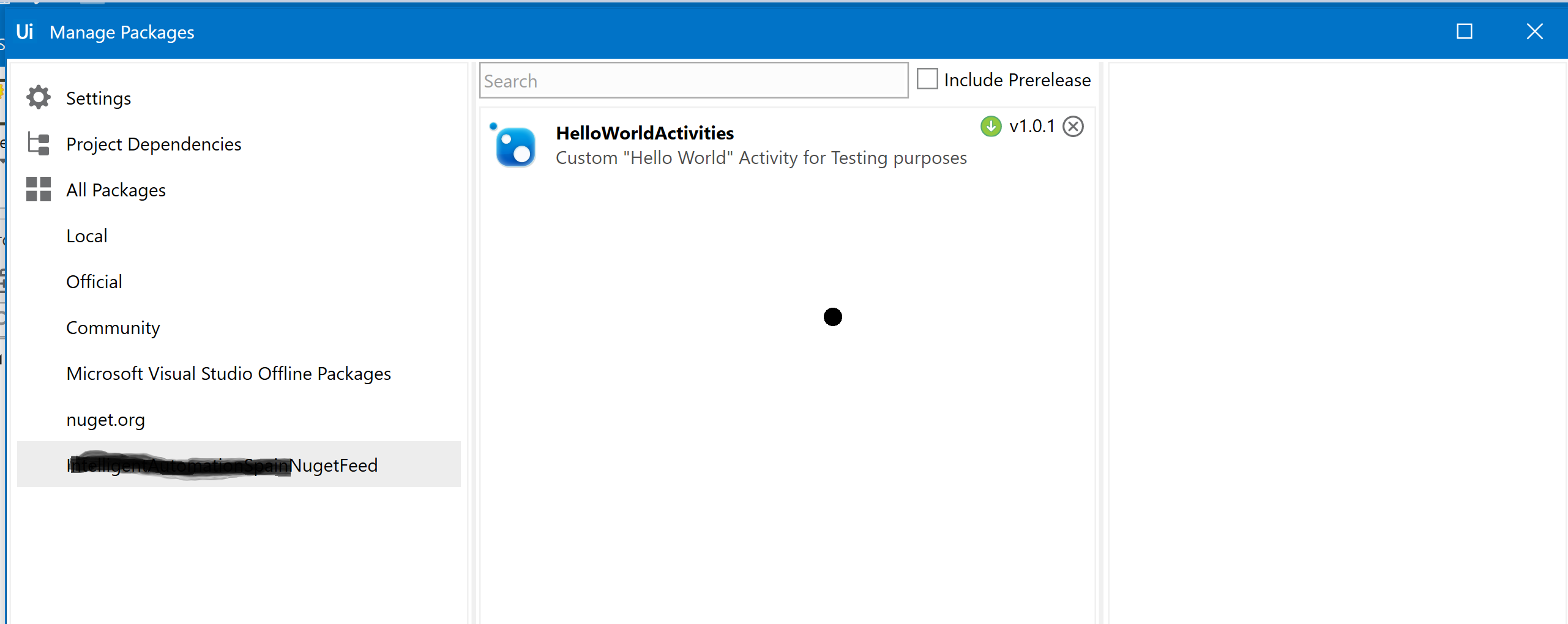

@loginerror @mircea Thank you very much. Worked flawlessly.

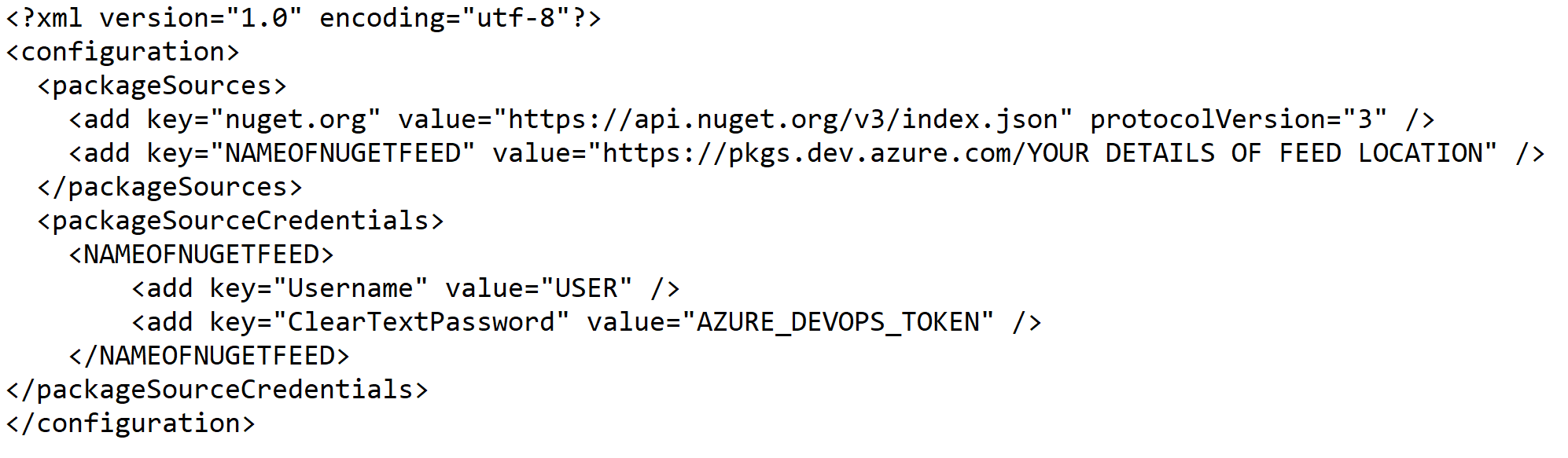

Could i see your config?
Sure:

Hey Gerado
Your “User” in username, is that your azure email or?
if you access your nuget feed URL in the browser, what is the response like?
  1. Yes, azure e-mail in my case.
  2. The actual json response, provided by the browser (please note you need to have proper browser access through authentication first)
Still no luck… :frowning:
