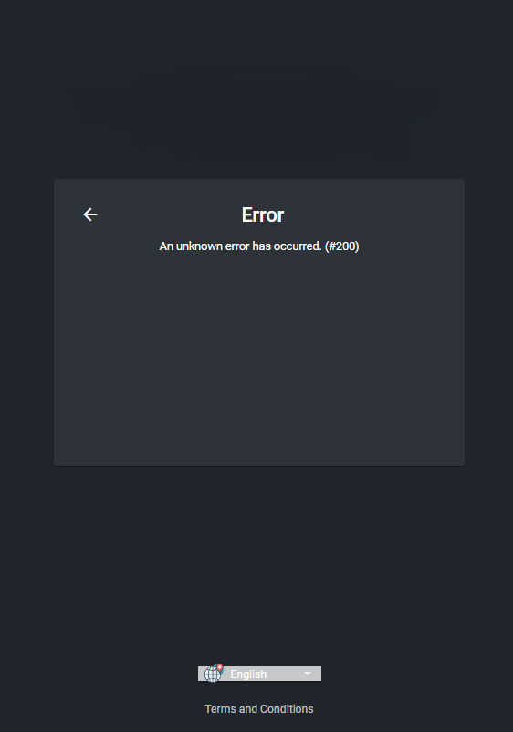

  • After navigating to the external URL and signing in via Microsoft Entra, the redirection either:
    • Redirects back to the internal URL (which isn’t reachable externally),
    • Or results in a error page status #200.

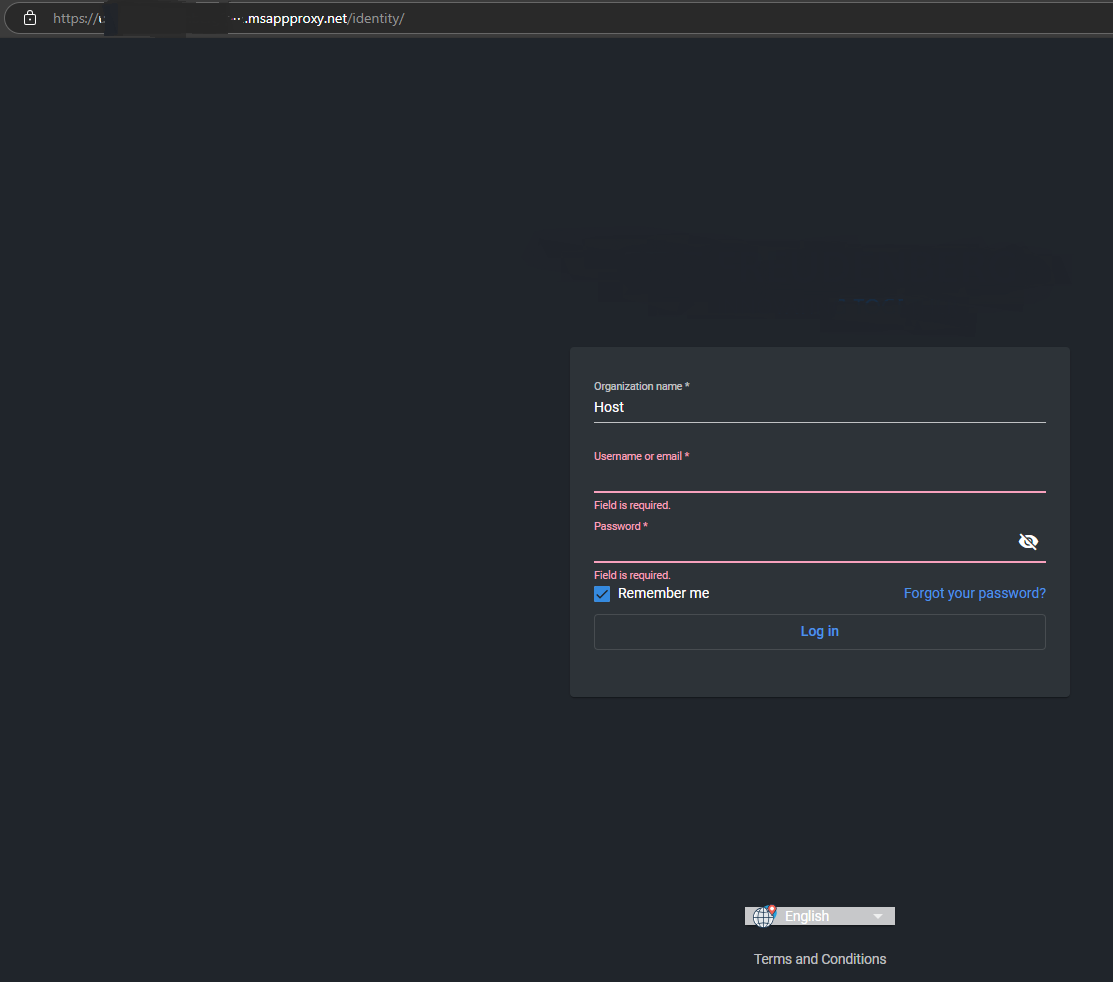

When I access the external link directly with /identity: https://company.msappproxy.net/identity the page loads and I can log in with my credentials::

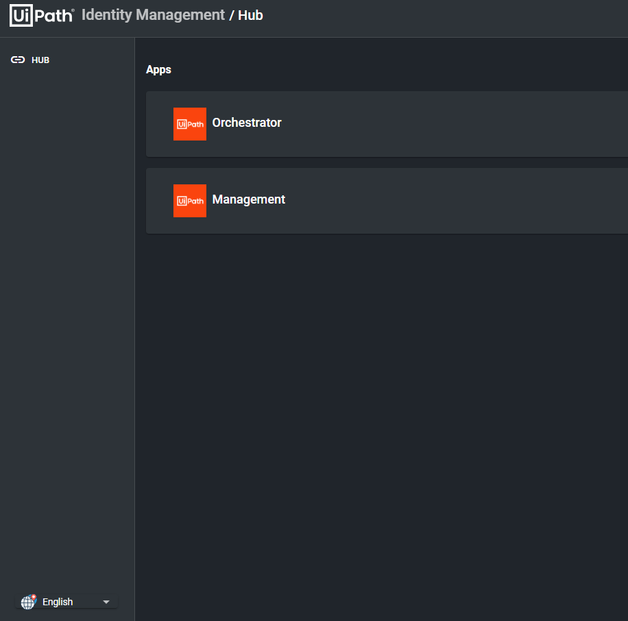

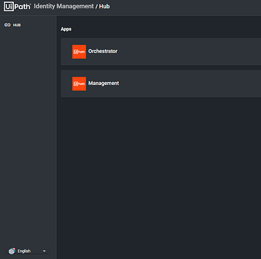

After logging in, the Identity Management page is displayed:

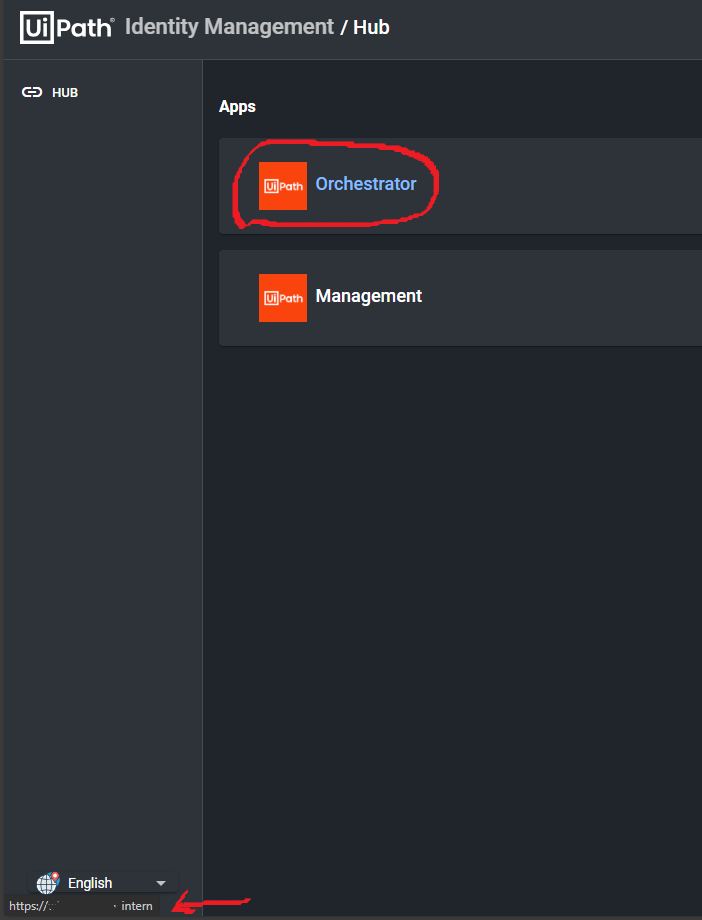

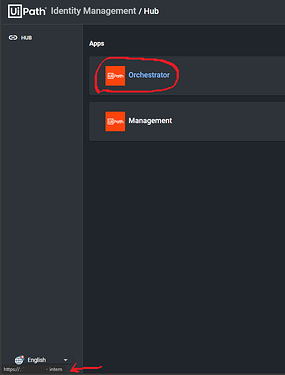

When hovering over Orchestrator, it shows the internal link
After clicking it, the page fails to load because it redirects to the internal URL:https://local.server.intern. The same happens when clicking Management even though the URL displayed on hover is: https://company.msappproxy.net/identity/management
it still tries to route to the internal address and fails outside the VPN.
