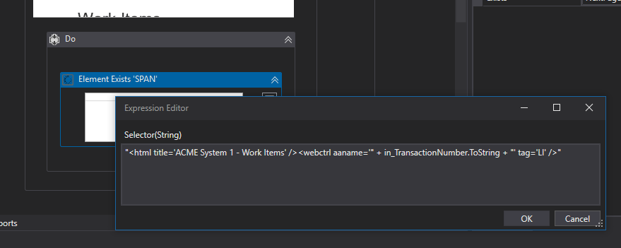

Hi @muthu.m
I don’t think you need to use attach browser within the get transaction xaml. If I remember correct, the element exists should be used without the attach browser…

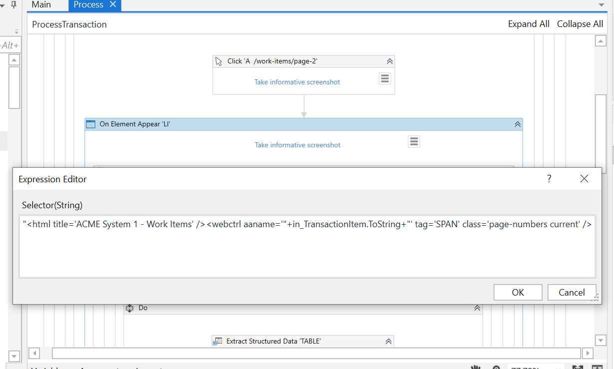

Hi @Lahiru.Fernando
PFA:
Assign2Selector
This is SELECTOR for On Elelment Appear
So in your selector, you are using the in_transactionItem to figure out the page number here. So in_transactionItem has the number like 1, 2, 3 and so on… This part is fine if you are passing the number as I assume here.
The next tag here in the selector checks whether the given page is the currently selected page
So, for me it looks like, the given page is not the current page here. That’s why it is giving an error…

Looks like you are trying to click on page number 2 to change the page and that’s where you are getting the error am I right?
The order should go like this…
In get transaction Data, you should check whether the page provided in TransactionItem exists…
You can use it as below
If page exists, you go to the process state right?
So in the process state first this you should do is, to click on the page mentioned in transaction item to change the page…
Once that is done, then you got to check whether the page changed to the clicked page. For that, we have to use the On element appear…
This order will help you solve the errors :slight_smile:
