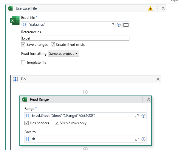

Can you try as the following?
Excel.Sheet("Sheet1").Range("A5:E1000")

  1. Drag a use excel file activity and provide the file details as you are only using read…from properties you can check readonly property
  2. Now inside use excel drag a for each sheet in excel activity
  3. Inside the loop use your read range with Excel.Sheet(currentSheet).Range("A5:E1000")
