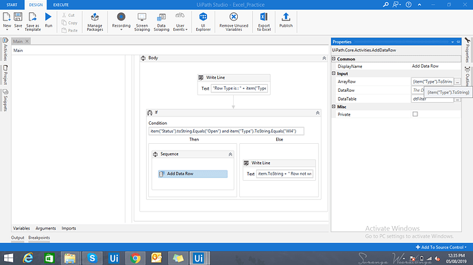

Hi All,
I am trying to filter certain data extracted from webpage adding it to a dataTable and the writing the whole data table in the .xlsx file.
But, I am getting the data System.data.datarow in excle file, please refer the below screenshots:

Please try dtFilter.ToString
@Shruti_Rastogi i don’t know why you use add data row.
if you use fillter data table activity it directly gives you output datatable and there you can use write range.
-but if use datable.select expression it gives you output as datarow
for that at last you need to add .copytodatatable.then it will work try to work on this let me know if any thing goes wrong.

I have used IF…please refer to the .xaml fileExcel_Practice.zip (32.0 KB)

There is nothing wrong with add range.
You are literally saving the datarow as “System.Data.DataRow” into the datatable. This is because you added data row to dtFilter using “{item.ToString.ToString}” as arrayRow. You may try to use {item(“WIID”).ToString} instead.
If you want all values, use {item(“WIID”).ToString+item(“Status”).ToString+…}
You may refer to my attached file.Main.xaml (12.2 KB)
Thank you, It worked,
