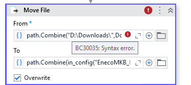

I have a project that ran hundreds of times. Now all of a sudden it gives errors.
For example this. It says there is something wrong with the last add data row. When I delete that activity all of a sudden there is something wrong with the activity above. How to fix this?
Also this error:

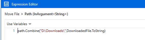

When I open it, no problem at all:

Thank you for the project @Dion . I was able to reproduce this on the latest Studio 2023.12 as well.
We will investigate further, but so far my findings are that:
  • the error BC30037: Character is not valid is due to the € character in the string
  • the error BC30035: Syntax error seems to be due to the : character in your path
    For both of the above, a temporary workaround would be to provide those inputs as a variable (this should work and “skip” the issue of a validation error)
  • the error BC30198: ')' expected seems to be some sort of issue with parsing of the specific expression. I was able to work around it by adding some extra line breaks like so:
I know all the above are just workarounds, but I figured it might come useful while we investigate it further and work on a fix.

I did more digging by trimming the workflow, because it was a really strange issue. I found this activity with one double quote too much:
It somehow messed up Studio validation flow and things escalated really quickly. Removing the extra double quote should be the actual solution.
EDIT. Of course, we will have a look at this, because Studio should contain the error to the single activity with the issue.
