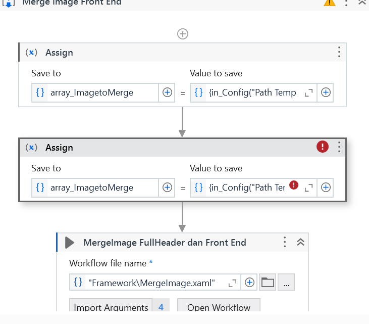

I’m assigning value to argument in Invoke Workflow like above and this error suddenly appeared. I believe I write it right cause I always did like that.
and when I clear the value from it, the syntax error suddenly move on to the activity above it like this:

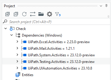

The UiPath Version is 2023.12.0
system dependencies I used before is 23.4.3 and I tried downgrade it to 23.4.3
still not working.
I even restart my laptop and still no go

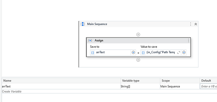

But I create a test project with similar your argument and variable type
and I have any error similar you
I have checked packages
and json file

I’m getting the same error when working in your project but when I created a new project and did the same assign activities it worked well. There might be issue with the project try creating a new project.
