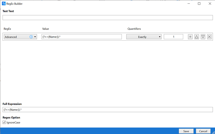

Kindly Check these articles, will help you to build regex expression using Matches…
I have given a sample to get value with reference to string “Name:” in input text
The output will be…
Hope this will help you.
