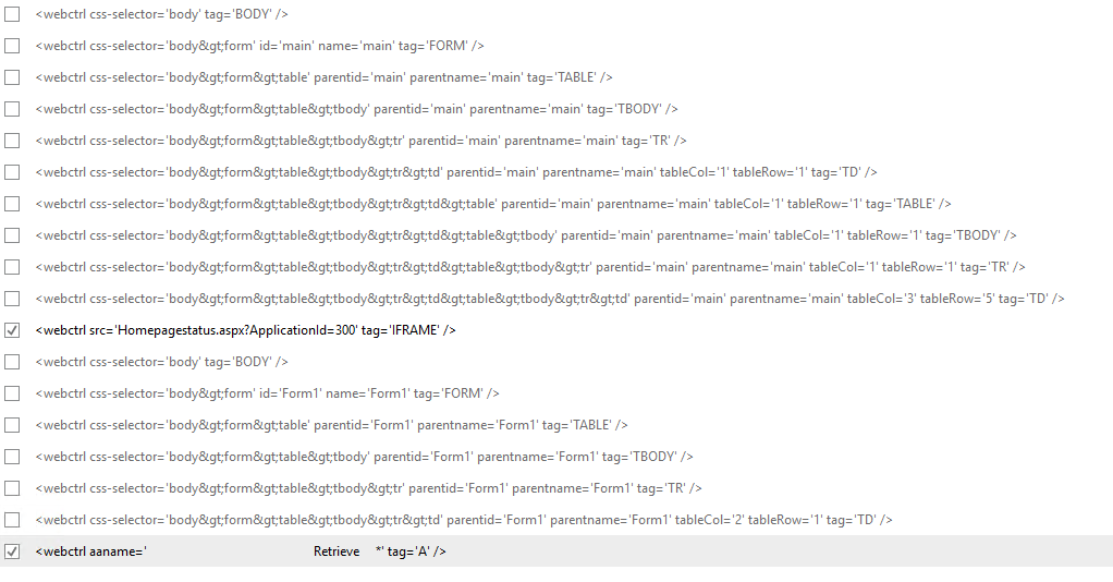

I am using click but it’s not working. See below selectors while capturing Through click.
That’s not a very good selector. You can’t just rely on what UiPath gives you, you have to tweak your selectors to make them right. Is this a public web page? If so, give us the URL.
I tried to use different things from ui explorer on this selectors , but that’s not work. It is private URL from company so, I can not provide.
Is the applicationId always 300 in the Iframe URL?
First thing I would try is to replace all the spaces in aaname with *. So…
<webctrl aaname='*Retrieve*' tag='A' />
I did . And It is working.
Thank You so much @postwick I Really Appreciate it.
Great, glad I could help. It’s frequently necessary to edit selectors, not just use what UiPath gives you. You have to consider that properties of an element could change each time the page loads, or when the owner of the page makes changes. For example, css-selector is not good to use, too much chance it changes in the future. aaname is usually good, and tag. You want your selector to be as simple as possible while still being unique on the page.
