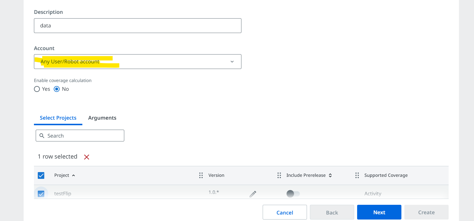

can you help me on this why is it pending state
i have publish the test on orchestrator as well
here on orchestrator
that account/ robot it is not showing any robot to execute
@mint
That means no testing license is allocated to any machine or robot
Orchestrator->Tenant->Machines->Edit machine->Allocate testing license
Also check if robot role is assigned to any user
Orchestrator->Tenant->Manage Access->Edit->Assign robot role
cheers
