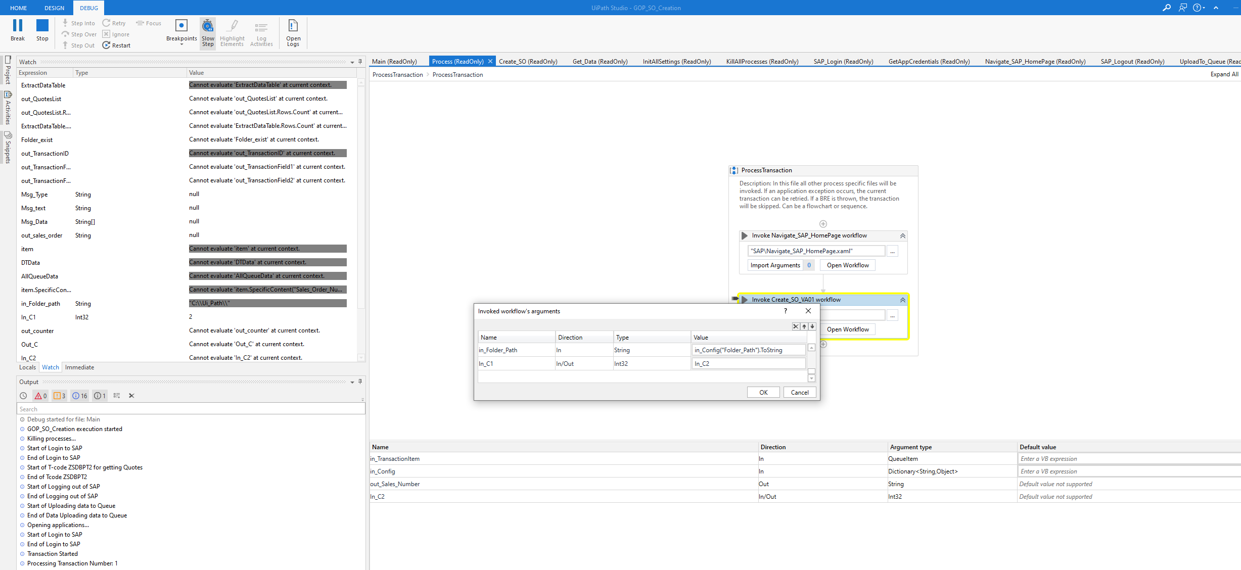

I tried with the in/out arguments but still the same issue.Please find the attached screenshot.
As you can see this is the second transaction and the in_C1 argument is still having value as 2.
Are you iterating in_C1 or counter? you should be iterating in_C1
I am iterating in_C1
And to you have in_C1 set as an in/out argument in “Process” as well?
This is the process screenshot.
I certainly have a doubt that somewhere i might have done a silly mistake. :slight_smile:
