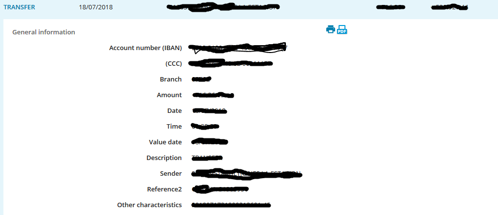

I need to extract the data from a bank portal and the data will be as I have mentioned in the screenshot. I will get all transactions in one page and I need to go into each transaction and extract all the data in it. As in the attachment main page that is how transactions will look like and when I click on transfer I get the second screen shot. So I want to get the details as in second screen. Can any one help please.
Note: When I click on transfer the URL will not change if it would have changed then I would have done it as we do in level 3 assignment.
