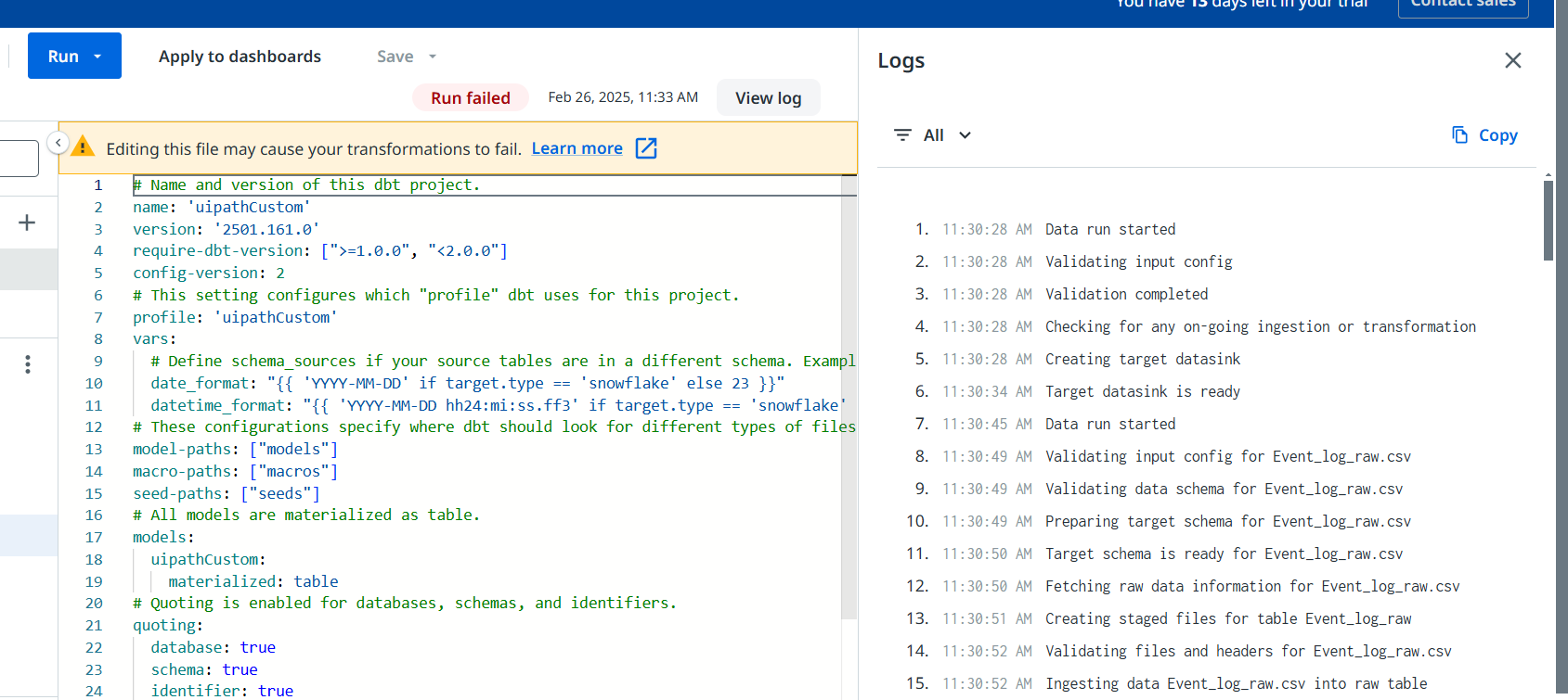

@ankit.saraf I am getting error
Hii,@srijanani.kj

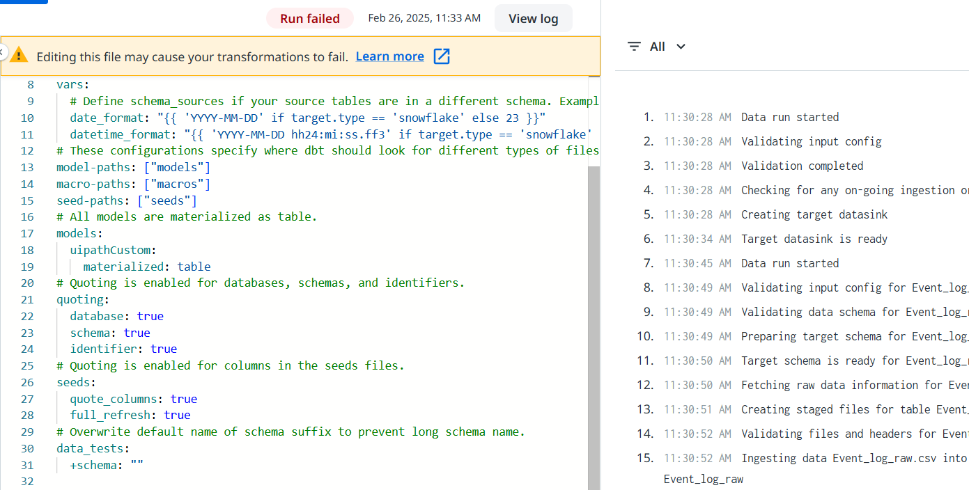

For Processing mining after upload the data i amgetting an error but i added the Event_end Column
@Lingaraja_Tanuja - Couple of questions to help you here -
  1. Are you using the sample file above? or using some other file to upload?
  2. Which app template are you using?
  3. Can you please share how vars section of your dbt_project.yml looks like?
Hii-@ankit.saraf
I am Using CSV File Format For Event log Template
Can you please try to update the datetime_format from YYYY-MM-DD hh24:mi:ss.ff3 to YYYY-MM-DD hh24:mi:ss and try again?
