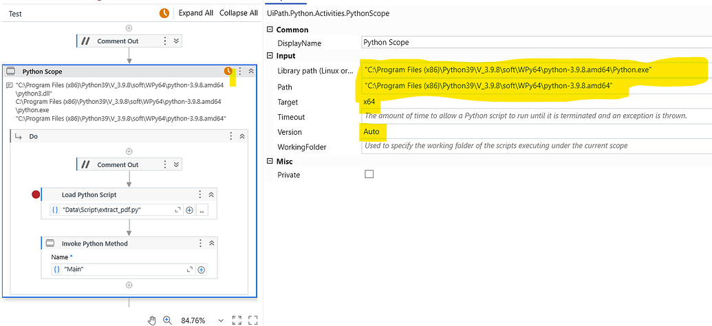

I am need to invoke python code into UiPath studio workflow. I am using python scope, load python script and invoke python method.
Im using correct dlls and folders.
python 3.9.8 version
But receiving error in Python scope itself.
Kindly suggest alter techniques to invoke python code.

From your provided snip, you have AMD 64 architecture.
Please sleect correct target try & try.

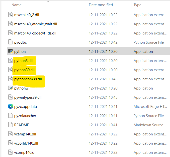

Do we need to specify python.exe python anywhere in python scope activity.
can u correct which dll path i should provide
but i tried all below
Also please correct me any property field is worng.
The run is stuck in python scope activity everytime

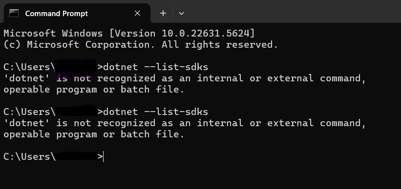

generally when the run is stuck it is the .net runtime issue
try to open event viewer from start window and check there should be some error related to .net
please install.net 6 based on the version of python pavckage you have
also python39.dll is what you need to provide

It’s .Net version not installed on your machine issue. Get this version installed and you should be fine.

1. Check if you have .NET installed:
In CMD, type dotnet --list-sdks
It will list out framework you have installed as below:

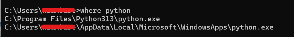

2. Get python path:
To know exact path of python open CMD and write below “where python”
You will get the path something as above. Remove .exe from path & pass it to Path argument in the activity.
C:\Program Files\Python313
Here 313 is python 3.13.3 version.

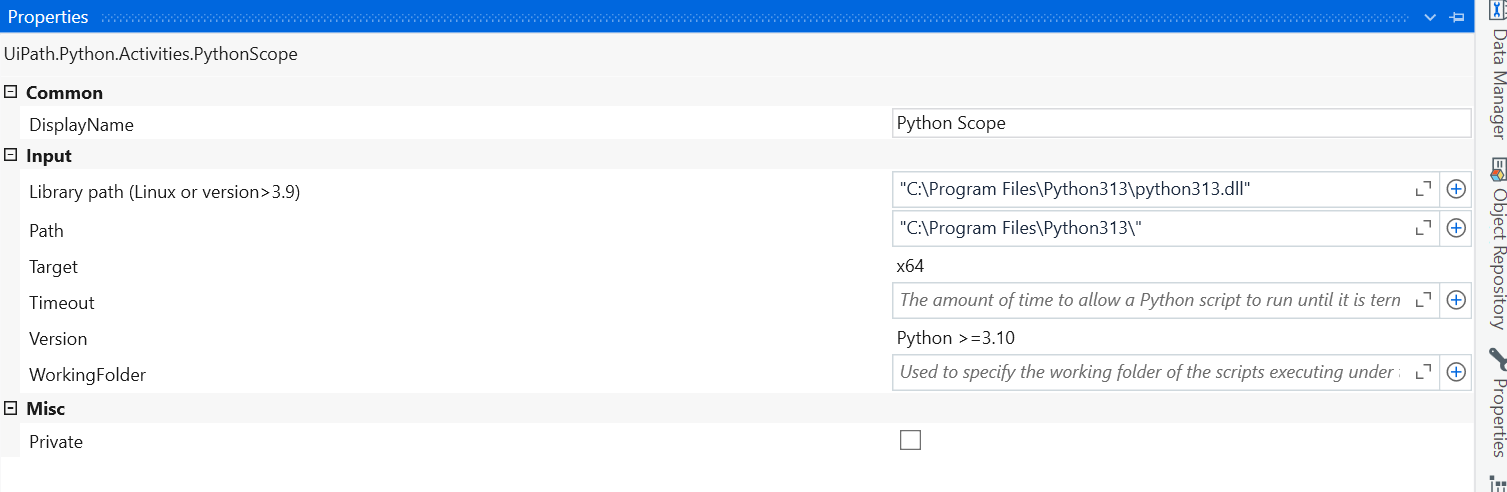

3. Library Path Argument: Path which incluse Python.dll file.It is location in same folder. In my case it is as follows:
C:\Program Files\Python313\python313.dll
4. Target: To find target open CMD & type python. You will get below output:
So, your installed python has x64 target type.
5. Python version: From step number 4, you will get the version.
Hope this helps you to configure python scope.
Please let me know if you have any doubts. Else mark as solution :slight_smile:

Hello @Nikhil_Zambare1,
i have provided all correct information to python scope activity.
please find below screen,

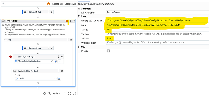

Please provide me Python Scope Argument snap to understand better.
The initial snap you have shared has wrong Library path & Python path. Attaching your provided earlier snap for reference.
