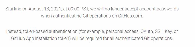

In github click on clone repository, you’ll get the credentials there. You should use that one.
Or you can create a token there and use it for authentication.
Both are unique key generators.
Thanks for your commit. But that won’t help. It’s the exact same method as the docs provided from UiPath. It’s not that I or we don’t understand how to connect but the problem we’re facing with authentification via GitHub when our credentials are typed in right and we have enough rights to do so.
What do you mean with credentials? Possibly the HTTPS link? Because that one I already used…
I can try creating a token, will tell if it has worked for me. Thanks a lot.
This is the reason

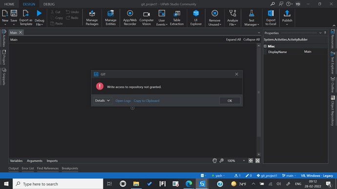

i am a first time user, also unable to push in github. it is showing this–
problem arise after i gave my username and password of github to connect with uipath.
