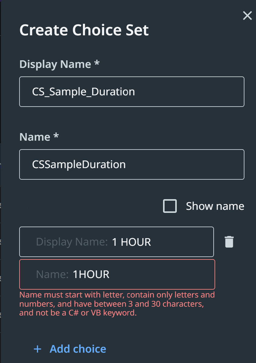

Hello,
I’m trying to create a Choice Set of data that has an attribute named “Sample Duration”. The standards defined in the data indicate that these sample duration units start with numbers.
However, DS does not permit creating Choice Sets with choices that begin with numbers. Am I missing something here?
I can get around this by creating an Entity instead. But the question is why can’t it be a CS?
Thanks!
-Andy
@AndyMenon ,
Name will be kind of variable name which cannot start with numeric value. You can use something like OneHour
or Hour1
. This will not be visible to user so will not spoil the UI.
Display Name you can use whatever you want and will be visible to user.
Thanks,
Ashok
