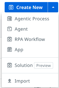

I created a Solution (Preview) in UiPath Studio web. I have added RPA Workflow in the solution. I am trying to add Agent to this solution, but I do not get the option to create Agent under Explorer. What am I missing? Is there specific settings or authorization that I am missing?
I can create a stand alone agent from Create New, but can’t add/import the newly created Agent to my solution.

Screenshot from Create New in Studio web:

Hi @Shreya_Gandhi
I think you’re using solution (preview) in UiPath studio web. this type of solution doesn’t support adding or importing agents after creation. the explorer panel won’t show the agent option because it’s not enabled for this structure.
you can try to create a standalone agent from “create new”, but it can’t be linked to an existing solution. to include both rpa workflow and agent, start by creating an agent first, then build your workflow inside it.

@Shreya_Gandhi
Looks like preview limitation in the enterprise version. We are expecting it general availability of this month or next max.
You can try community license till that for learning and poc
@Shreya_Gandhi
When you select solutions it would give a pop up to select agentic process,rpa etc..ideally anything you select should give all options..may be because of enterprise it might be a delayed feature as its still in preview ..so community orchestrator can help you there
Thank you, @ashokkarale. I did notice over the weekend a note from UiPath where they have mentioned there are Interface differences as these are all new. There are also some limitations as of now.
No worries, I will wait to explore this part until it is available for us or I will try to use community version until them.
